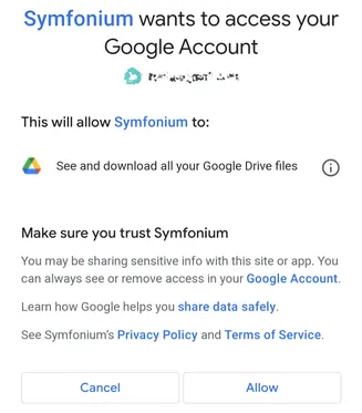

Press Sign-In with Google to open your browser, sign in to your account, and authorize access to your media files.
Symfonium does not receive your Google login or password. You can revoke its access from your account settings at any time.
Approve the requested access to continue. (See Privacy)
