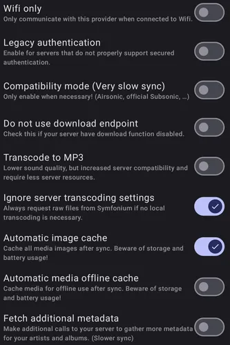

To access all available settings for a provider, edit the provider after it has been added. (Settings → Manage media providers: [Wiki] Settings - Manage media providers)
Subsonic, OpenSubsonic, or Navidrome provider detailed settings list
Enable this option to prevent Symfonium from accessing the server when not connected to Wi-Fi.
This setting is necessary for older servers, or in cases where the Ampache provider or LDAP accounts are being used.
This setting is required for servers that do not support the search3 endpoint with empty queries, especially in the case of Official Subsonic or Airsonic[-Advanced]. Symfonium is an advanced offline-first application that requires database sync. If the servers are not fixed, slow mode is mandatory. However, most providers have now fixed their implementation to support this. If your server requires this option, please contact me so that I can convince the team behind your provider to fix their side.
When in compatibility mode, Symfonium uses the download endpoint, which is usually more stable. However, some servers may have this option disabled. If you encounter this issue, please check this option
Enabling this option will make Symfonium transcode to MP3 instead of OPUS. This may be useful for servers that do not support OPUS or for those who prefer MP3 over OPUS. However, it’s worth noting that OPUS generally offers better sound quality at lower bitrates compared to MP3. Transcoding to OPUS may increase server resource usage compared to transcoding to MP3.
Enabling this option in Symfonium will ensure that the app requests the raw audio files from the server when there is no need for local transcoding. This can improve the audio quality and reduce the strain on the server’s resources as it does not have to perform transcoding.
Enabling this option will cache all media images locally on your device after each sync. However, it can also use up storage space on your device and potentially drain your battery faster if you have a large library with many images. It’s recommended to use this option if you have enough storage space available on your device and don’t mind the potential battery drain. If you have limited storage or battery life, it may be better to disable this option.
Enabling this option will cache all media files for offline usage after sync, allowing you to play your music even when you are not connected to the internet. However, this may consume a lot of storage and battery usage, so it is important to consider this before enabling this option.
This option allow additional calls to be made to your server to gather more metadata for your artists and albums. This includes information such as biographies, discographies, and images. Enabling these options can result in a slower sync process but can provide more complete and accurate metadata for your music. Additionally, these images may be used as a replacement for the images set up in your media tags. However, it’s important to note that enabling this option may result in increased data usage and slower sync.
