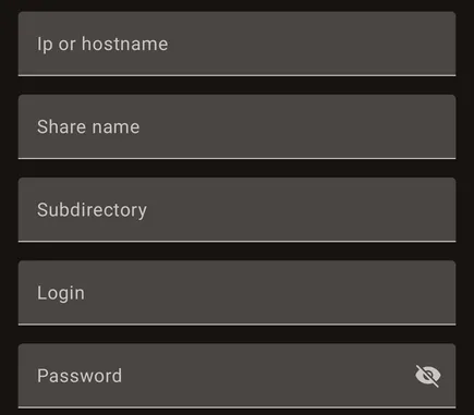

Open Settings → Manage media providers → Add media provider and choose Samba (SMB v2/v3).
Samba setup fields for the server, share, subdirectory, login, and password
For a network path such as \\Server\Share\Folder, enter:
Field Value Details
IP or hostname Server The server name or IP address. NetBIOS names are supported.
Share name Share The shared folder on the server.
Subdirectory Folder The folder inside the share to scan. Leave empty to scan the whole share.
Enter your Login and Password. Both are required. Anonymous access is not supported.
Review the artwork options, then press Add to connect and scan the selected location.
