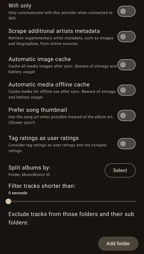

All settings
Section titled “All settings”After adding the provider, open Settings → Manage media providers, select it, and choose Edit. Change its Display name and folders, or review its connection and authentication details. Press Update to save. The provider must be online so Symfonium can test the changes.

Wi-Fi only
Section titled “Wi-Fi only”
Only communicate with this provider when the device is connected to Wi-Fi.
Scrape additional artist metadata
Section titled “Scrape additional artist metadata”
Retrieve supplementary artist images and biographies from online sources. When enabled, Clear scraped data lets you remove previously scraped artist data.
Prefer track thumbnail
Section titled “Prefer track thumbnail”Use each track’s artwork when available instead of the album artwork. This is useful for compilations with different track images, but makes synchronization slower.

Automatic image cache
Section titled “Automatic image cache”
Cache all media images on your device after each sync. This uses additional storage and battery, especially with large libraries.
Automatic media offline cache
Section titled “Automatic media offline cache”
Cache media for offline playback after each sync. This can use substantial storage, network data, and battery. See Offline media cache and downloads for the available caching options.

Tag ratings as user ratings
Section titled “Tag ratings as user ratings”
Treat ratings imported from file tags as user ratings instead of scraped ratings.

Split albums by
Section titled “Split albums by”
Choose which fields must match for tracks to belong to the same album, such as Folder, MusicBrainz ID, and Album version.

Exclude tracks shorter than
Section titled “Exclude tracks shorter than”
Set a minimum track duration to filter out unwanted short media.
Exclude folders
Section titled “Exclude folders”
Under Exclude tracks from those folders and their subfolders, press Add folder to exclude paths from synchronization. This removes those folders from the library without deleting files from the provider. When available, you can also restore files previously hidden from Symfonium here.
